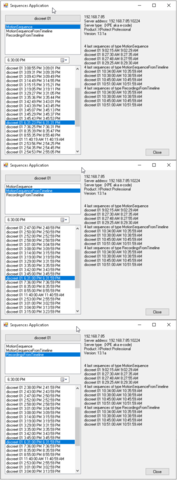

I recommend that you use the small sample I made on “Sequences” to understand what is available and possibly to trouble shoot the situation.
You can be in a situation (my guess) that there is recorded footage outside the periods covered by the sequences data. In that case your solution might have to be changed, and I think if you ask the export to cover the whole period wanted instead of filtering on sequences data you can export all of the footage.
http://download.milestonesys.com/MIPSDK/Samples/Sequences.zip
Thanks, Bo. Looks like this sample might help. With it, I was able to see that on each of the methods for getting data, there is a way to get a result for the particular sequence we are hunting.
I hope the sample is useful and leads you to a solution that will satisfy you and the customer. Thank you for the feedback.
Hi Bo, we got success in obtaining the sequence by tweaking the parameters and specifying as ‘TimelineRecording’. Not sure which resolved the issue.
