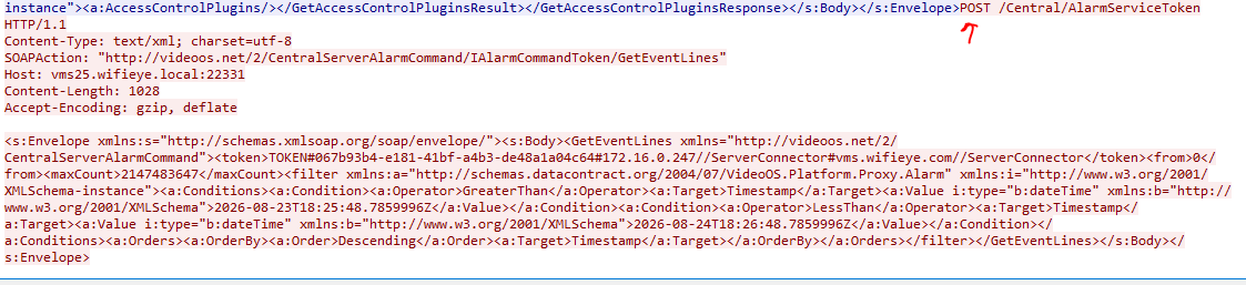

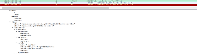

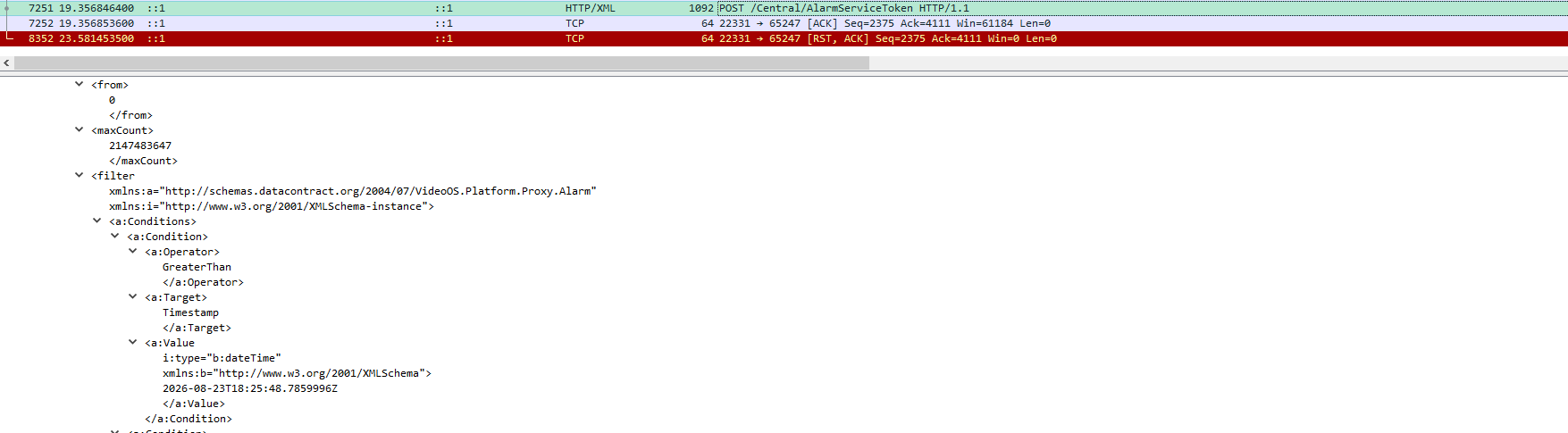

One user that using my Colored Timeline Pluing experience a strange, error that events are not loaded, I am unable to reproduce, wireshark trace just show that conn get RST, so ES close it.

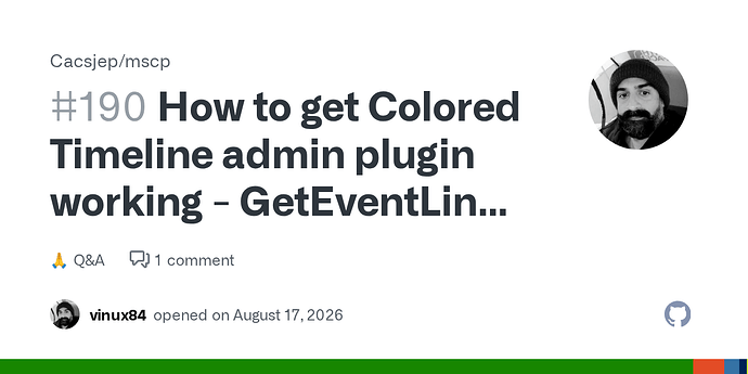

this is the GH issue: How to get Colored Timeline admin plugin working - GetEventLines / AlarmServiceToken failure on XProtect 2026 R1 · Cacsjep/mscp · Discussion #190 · GitHub
this is the MIP Exception Error: An error occurred while receiving the HTTP response to http://xxx:22331/Central/AlarmServiceToken. This could be due to the service endpoint binding not using the HTTP protocol. This could also be due to an HTTP request context being aborted by the server (possibly due to the service shutting down)

basically i am out of ideas, because i just invoke the MIP Call.
This issue entry has the complete expection with inner expection:
So for any reason ES decide to close and not to answer.
