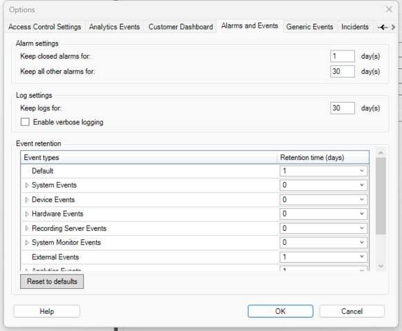

There might be a simple explanation. By default XProtect will not save events, so the moment they have occurred they are forgotten. To change this, in the Management Client, open Tools → Options, find the Alarms and Events tab, here you can configure saving events by setting a retention bigger than zero.
Be careful, this can cause the SQL Server database to overfill..
Thank you very much Bo - this was indeed the issue. I have just set all categories to 1 day, hopefully it shouldn’t cause too much database bloat.
