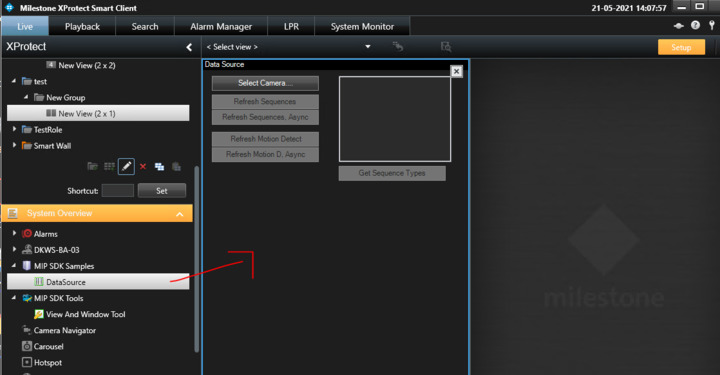

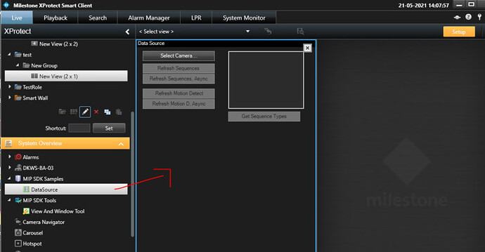

Let me give you an instruction for the plugin. First, please delete the folder that you created for deploying the dll because there should be a specific folder already here - [C:\Program](file:C:/Program) Files\Milestone\MIPPlugins\DataSource if you install SDK, please check the folder, dll and def file .
And you will be able to see following setting in Smart Client.
