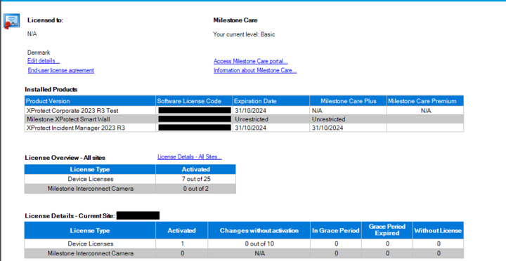

Hi Bo, the product I installed is Xprotec Corporate, and the license I got looks like this

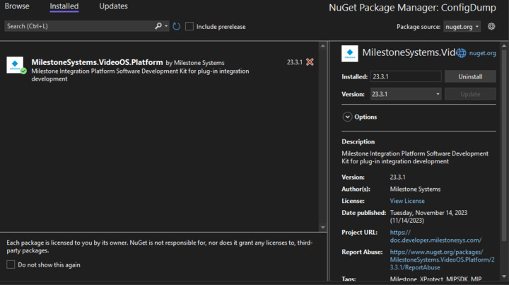

Simon, I have to ask the same question as for mr. Tram Ngo.. Are you building the plugin using the latest MilestoneSystems.VideoOS.Platform from NuGet?
I am running the latest (23.3.1) MilestoneSystems.VideoOS.Platform Nuget package:
