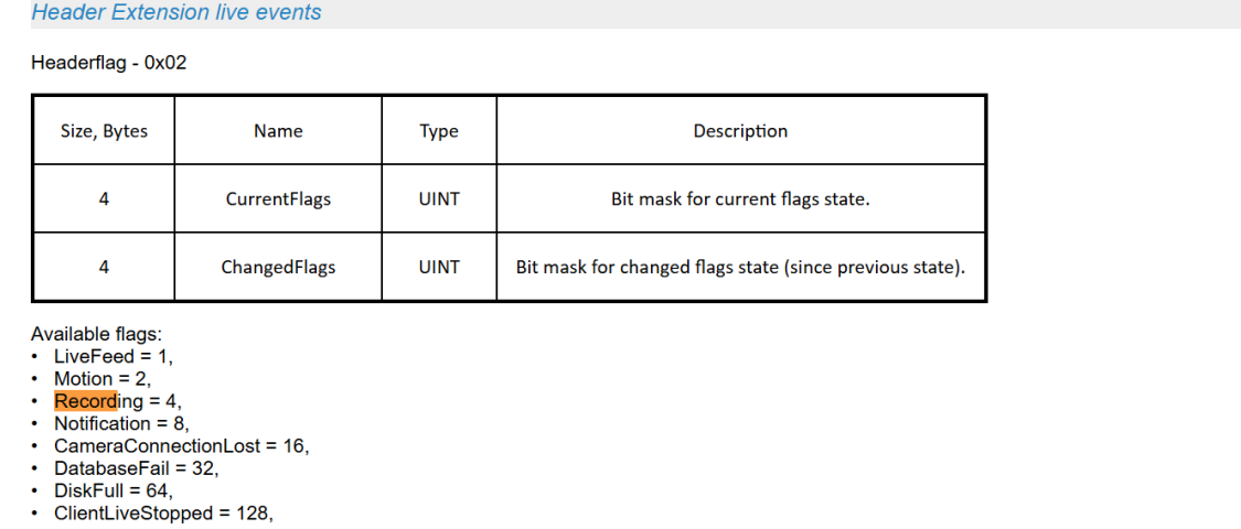

Hello
This is not possible, the only way you can know if a device is recording is in the Extension header as part of a live stream.
other options would be to ask the API-Gateway for configurations
