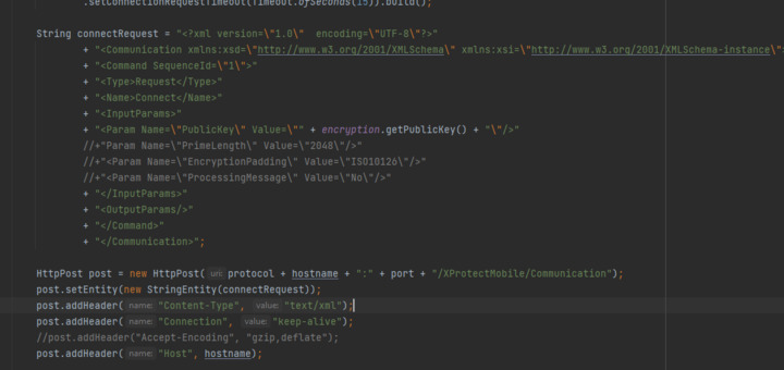

I use java for calling the server(soap)–>/XProtectMobile/Communication
1)“The processing instruction target matching \”[xX][mM][lL]\" is not allowed."

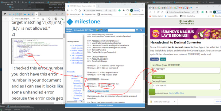

I checked this error number, you don’t have this error number in your document and as I can see it looks like some unhandled error because the error code gets the default value I guess.
First one has nothing to do with Mobile Server or mobile SDK. It looks Java-specific issue related to xml’s content and possible invalid whitespaces at the beginning of it. Did you try to google it and/or have a look at StackOverflow?

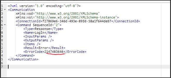

Second error (2147483646) is internal server error. Can you please provide the request?

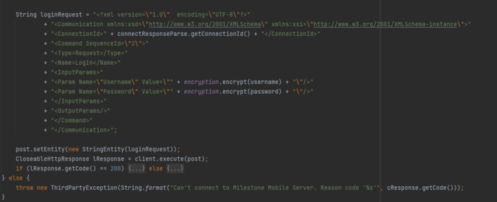

It’s for login–> then getting connectionID

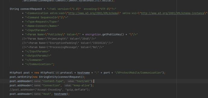

step1)

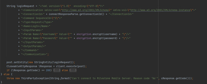

step2)
same as the previous error, if u do this request a couple of times, sometimes you get this error but the rest u get connectionId

I’ll try to do it, but at least for part 1–> it’s obvious that you have an internal error, so If you have a logging system, let me know, and I can send the error log for you to check it
As you can see, you send :
2147483646 = (0x7FFFFFFF = Unknown)-1 = Unknown – 1 = Internal Error
