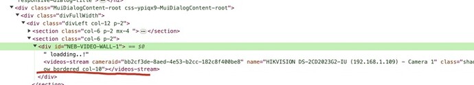

We are integrating video stream in our application by using web sdk of milestone , and by refering to the videostreams sample application. Though component is created the video control is not getting created.
