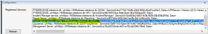

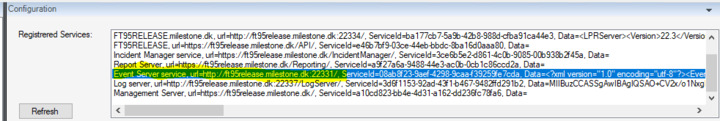

Service Test sample might be helpful, please see this sample link - https://doc.developer.milestonesys.com/html/index.html?base=samples/pluginsamples/servicetest/readme.html&tree=tree_1.html
Thank you! After a bit more digging I should probably use VideoOS.Platform.Configuration.GetRegisteredServiceUriInfo(Guid serviceType, ServerId serverId), where serviceType is the static guid VideoOS.Platform.Configuration.MAPServiceType.
