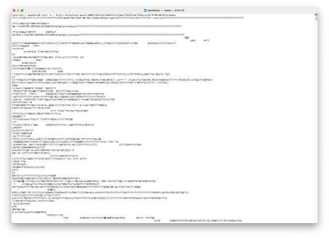

We’ve also tried using MJPEG, but for some reason we’re not receiving any headers for that.
Is there a way to get the headers with the stream?
See this picture:
