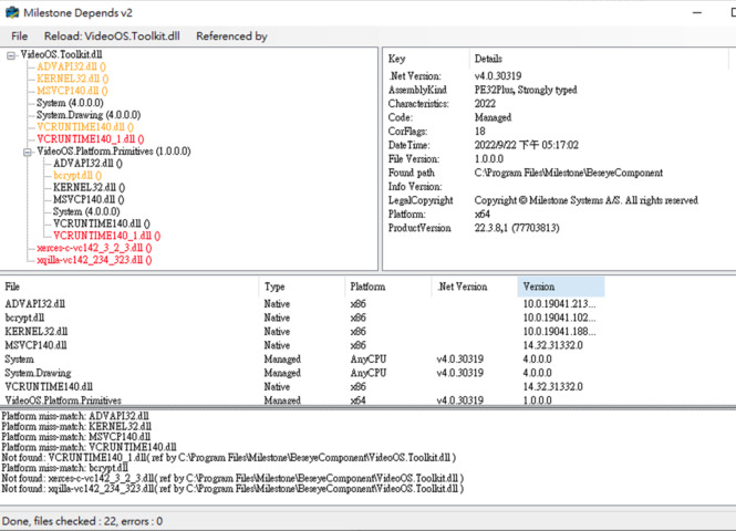

Use MDpends.exe to load ‘VideoOS.Toolkit.dll’ in the installation folder. Platform miss-match dependencies are as below:
How could I fix the problem to make the component work?

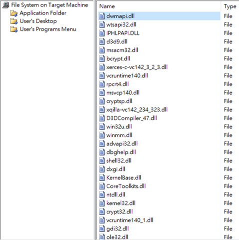

I’ve added all miss-match dlls. Re-built, re-installed and executed it.
Got the following message:
Unhandled exception: VideoOS.Toolkit.FileException: Could not open file ‘CoreToolkits.dll’!
From VideoOS.Toolkit.ToolkitFactory.CreateInstance(String configurationXml)
From VideoOS.Platform.Common.InternalCommandServiceCommon.CreateAndRegisterToolkit[T](String configXml)
From VideoOS.Platform.SDK.Export.SDKInternalCommandService.ImageExporterConnect(FQID deviceFQID, Int32 width, Int32 height, Boolean keepAspectRatio, Boolean fillSpace, Boolean allowUspcaling)
From VideoOS.Platform.Data.JPEGVideoSourceImplementer.<>c__DisplayClass2_0.b__0()
From VideoOS.Platform.Data.GenericVideoSource`1.InitInternal(Func`1 imageExporterConnect, Action onConnected)
I found those type I added would be ‘file’ not ‘assembly’. Is that the problem?
