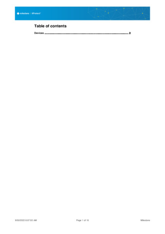

Please find uploaded Devices Configuration Report from Milestone Management Server from one of the locations affected.
