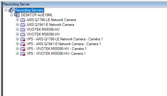

We are trying to integrate our video analytics solution through the VP Service. Following your demo, each VPS will create a new hardware device and link it to one camera. Since we have four streaming videos, we will have in total 8 devices and each camera will have its own VPS.
My question is: is there a way to associate only one VPS device to the 4 cameras which will result in 5 devices in total. In such a way, the one VPS device will become able to handle the 4 cameras.
PS: our license supports only 5 devices.

We found that when working with MIP SDK 2021 R1 we don’t need a device license for each VPS which was not the case with our situation. Are we missing something here please?
vps
Is the camera device under VPS hardware enabled? If you’re not sending video back to XProtect you can disable camera device on VPS hardware. It will still send the stream to VPS Service but it should not use a license.
Following your suggestions, we disabled the hardware under each VPS and it works well. (solved)
