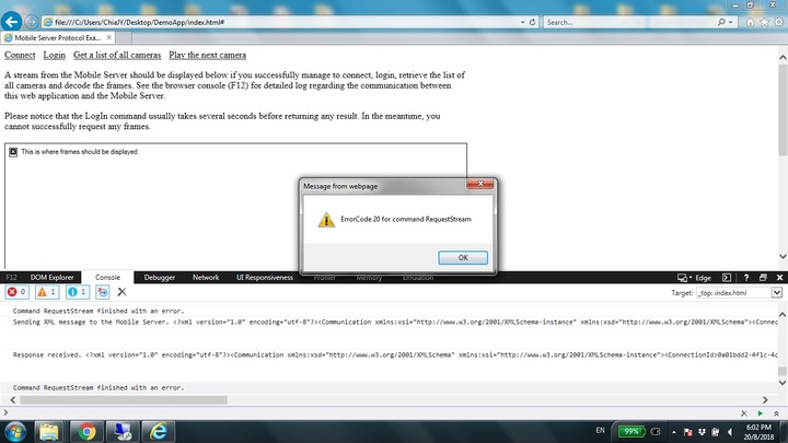

Hi Petar, apologies for my slow reply.
OS used is in English. The user account type is local windows (administrator).
Error Code 20 appears if re-attempt to login within 1 minute. Notice after 1 minute, login most likely successful. Attached is the screenshot
For wireshark trace might be a bit difficult for my as the mobile server is behind proxy.
