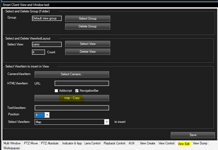

You might want to see how to work the sample wit a map. We just tested it and please see below.
Deploy the sample and start Smart Client. In the setting mode, deploy Smart Client View and Window Tool to a view in Smart Client.
See following setting and it should work.
