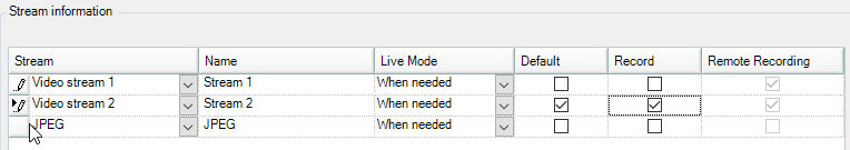

I’ve read the attached article, and from what I understand, I should be able to configure two streams for recording. Then, depending on the stream I’m using for live video, when I switch to playback, I should be able to use the same one. However, I assume that due to my license, I’m unable to set up two streams for recording. See the attached image.
So, I understand that I should use the edge storage option instead of adaptive streaming. My question, then, is: when I send a manual recording command from my application, or an event triggers the recording, will the camera start saving video to its SD card, while the recording server simultaneously stores low-quality video in its database? Then, if I create a button labeled “retrieve data,” would the HD video be saved in parallel with the low-quality video in the recording server database, and would the PlaybackController handle displaying the HD video to the operator? Is that correct?

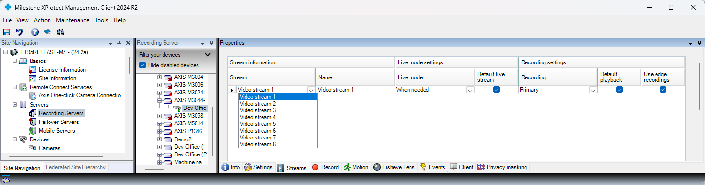

Note that XProtect Corporate does support two streams of recording, I must suspect you have an older version where this was not yet introduced.
