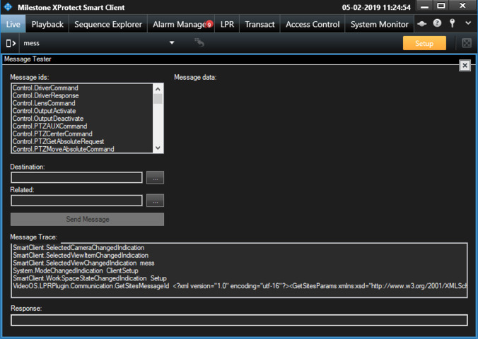

Hello,Is it possible from a Smart Client plugin to detect that the client has entered/leaved the Setup-mode?Best regards,Mathias
Yes. There is a “WorkSpaceStateChangedIndication” that you can use.
In order to see this for yourself I recommend that you explore the Message Tester tool plugin sample:
https://doc.developer.milestonesys.com/html/index.html?base=samples/messagetester_sample.html&tree=tree_1.html
