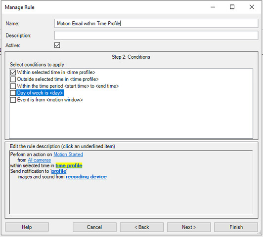

Hi Hardo,
I don’t think the mail server or notification profile settings are available via MIP SDK, but I think you can create a rule to send notifications within a time profile to meet this need. See the rule example below for reference
