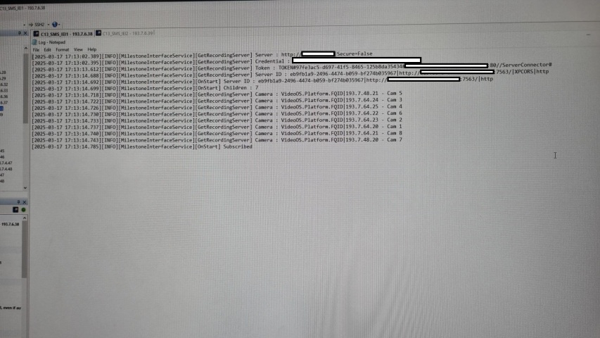

We are able to get the camera subscription as shown on the test file attachment.
However when we unplugged the cat6 cable connecting to the camera to simulate the camera going offline, we are not able to get the status.
From our understanding the SDK should be able to get the camera status and hence we would like to check if we are missing anything in our code.
I have attached the log file as well as the code we are using to get the status.

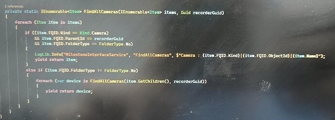

If it does not work and you want to illustrate code changes you have done to the original sample, please paste code snippets, please do no use pictures taken of your screen. If you have to show what is on screen, not source code, please use a screen capture tool (Windows Snipping Tool or other).

Here is the code snippet as requested.
Would like to check is there anything we are missing

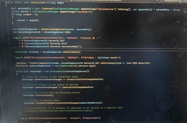

public static void Initialize(string\[\] args)
  bool secureOnly = bool.TryParse(ConfigurationManager.AppSettings\["SecureServer"\].ToString(), out secureOnly) ? secureOnly : false;
  string server = ConfigurationManager.AppSettings\["ServerUri"\];
  if (args.Length > 0)
    server = args\[0\];
  var recordingServer = GetRecordingServer(server, secureOnly);
  var recordingServerId = recordingServer.FQID;
  [LogLib.Info](https://LogLib.Info)("MilestoneInterfaceService", "OnStart", $"Server ID : "
    + $"{[recordingServerId.ServerId.Id](https://recordingServerId.ServerId.Id)}"
    + $"|{recordingServerId.ServerId.Uri}"
    + $"|{recordingServerId.ServerId.ServerScheme}");
  List<Item> allItems = recordingServer.GetChildren();
  [LogLib.Info](https://LogLib.Info)("MilestoneInterfaceService", "OnStart", $"Children : {allItems.Count}");
  \_devices = FindAllCameras(allItems, [recordingServerId.ServerId.Id](https://recordingServerId.ServerId.Id)).ToDictionary(item => item.FQID.ObjectId);
  ISet<Guid> subscribedDevices = new HashSet<Guid>(\_devices.Keys);
  using (var statusApi = new StatusSession(recordingServer))
    // Listen for changes to the connection state
    statusApi.ConnectionStateChanged += ConnectionStateChangedHandler;
    // Listen to changes to the states of devices
    statusApi.CameraStateChanged += CameraStateChangedHandler;
    // Start the session with the Recording Server
    statusApi.StartSession();
    // Subscribe to devices found
    statusApi.SetSubscribedDevicesForStateChanges(subscribedDevices);
    //// Alternatively, it is possible to subscribe to all devices of a specific kind.
    //statusApi.AddSubscriptionsToDevicesOfKind(Kind.Camera);
  [LogLib.Info](https://LogLib.Info)("MilestoneInterfaceService", "OnStart", $"Subscribed");

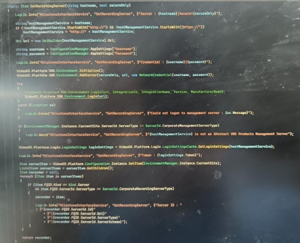

static Item GetRecordingServer(string hostname, bool secureOnly)
  [LogLib.Info](https://LogLib.Info)("MilestoneInterfaceService", "GetRecordingServer", $"Server : {hostname}|Secure={secureOnly}");
  string hostManagementService = hostname;
  if (!hostManagementService.StartsWith("http://") && !hostManagementService.StartsWith("https://"))
    hostManagementService = "http://" + hostManagementService;
  Uri uri = new UriBuilder(hostManagementService).Uri;
  string username = ConfigurationManager.AppSettings\["Username"\];
  string password = ConfigurationManager.AppSettings\["Password"\];
  [LogLib.Info](https://LogLib.Info)("MilestoneInterfaceService", "GetRecordingServer", $"Credential : {username}|{password}");
  VideoOS.Platform.SDK.Environment.Initialize();
  VideoOS.Platform.SDK.Environment.AddServer(secureOnly, uri, new NetworkCredential(username, password));
  try
    //VideoOS.Platform.SDK.Environment.Login(uri, IntegrationId, IntegrationName, Version, ManufacturerName);
    VideoOS.Platform.SDK.Environment.Login(uri);
  catch (Exception ex)
    LogLib.Error("MilestoneInterfaceService", "GetRecordingServer", $"Could not logon to management server : {ex.Message}");
  if (EnvironmentManager.Instance.CurrentSite.ServerId.ServerType != ServerId.CorporateManagementServerType)
    LogLib.Warn("MilestoneInterfaceService", "GetRecordingServer", $"{hostManagementService} is not an XProtect VMS Products Management Server");
  VideoOS.Platform.Login.LoginSettings loginSettings = VideoOS.Platform.Login.LoginSettingsCache.GetLoginSettings(hostManagementService);
  [LogLib.Info](https://LogLib.Info)("MilestoneInterfaceService", "GetRecordingServer", $"Token : {loginSettings.Token}");
  Item serverItem = VideoOS.Platform.Configuration.Instance.GetItem(EnvironmentManager.Instance.CurrentSite);
  List<Item> serverItems = serverItem.GetChildren();
  Item recorder = null;
  foreach (Item item in serverItems)
    if (item.FQID.Kind == Kind.Server
      && item.FQID.ServerId.ServerType == ServerId.CorporateRecordingServerType)
      recorder = item;
      [LogLib.Info](https://LogLib.Info)("MilestoneInterfaceService", "GetRecordingServer", $"Server ID : "
      + $"{[recorder.FQID.ServerId.Id](https://recorder.FQID.ServerId.Id)}"
        + $"|{recorder.FQID.ServerId.Uri}"
        + $"|{recorder.FQID.ServerId.ServerType}"
        + $"|{recorder.FQID.ServerId.ServerScheme}");
  return recorder;

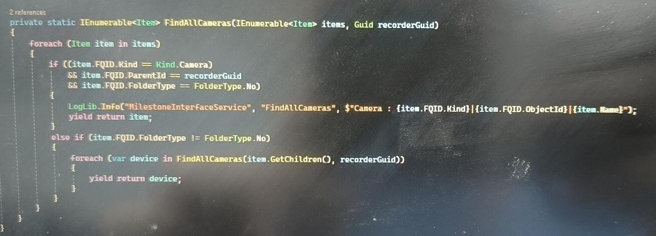

private static IEnumerable<Item> FindAllCameras(IEnumerable<Item> items, Guid recorderGuid)
  foreach (Item item in items)
    if ((item.FQID.Kind == Kind.Camera)
      && item.FQID.ParentId == recorderGuid
      && item.FQID.FolderType == [FolderType.No](https://FolderType.No))
      [LogLib.Info](https://LogLib.Info)("MilestoneInterfaceService", "FindAllCameras", $"Camera : {item.FQID.Kind}|{item.FQID.ObjectId}|{[item.Name](https://item.Name)}");
      yield return item;
    else if (item.FQID.FolderType != [FolderType.No](https://FolderType.No))
      foreach (var device in FindAllCameras(item.GetChildren(), recorderGuid))
        yield return device;

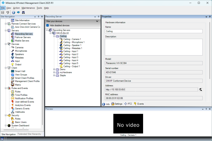

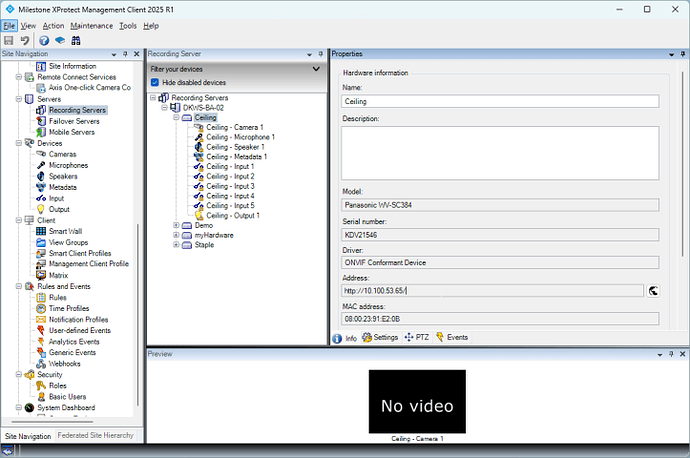

Let us establish first: If you use the Management Client and test removing the network cable do you see an error (yellow triangle icon)?
I ran the Status Session Console sample and observed (among a lot of other text output from the sample).
Disconnected the camera…
20-03-2025 15:52:00 - Camera state changes for Ceiling - Camera 1: Started (True) Recording (False) Motion (False) NoConnection(True)
re-connected the camera…
20-03-2025 15:52:27 - Camera state changes for Ceiling - Camera 1: Started (True) Recording (False) Motion (False) NoConnection(False)
Hi Bo,
Yes in fact when i un plug the cat 6 of the camera i am able to see the yellow triangle.
