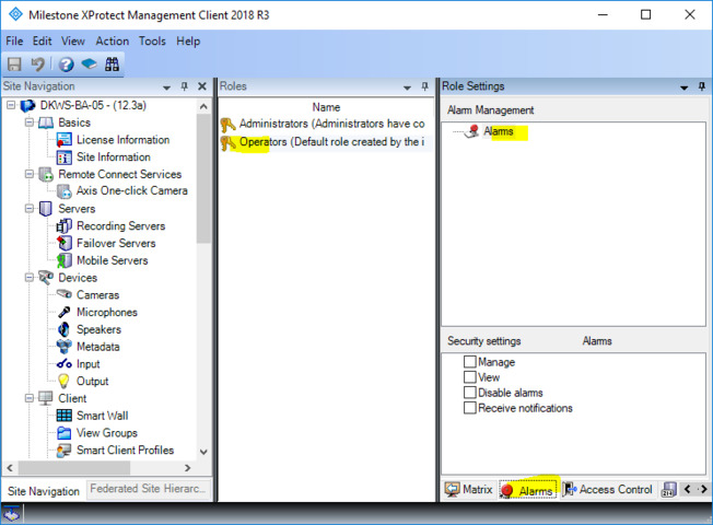

What you have achieved with this code is to a valid check even in big Corporate installation with differentiated admin rights. To illustrate let me show you this screen capture from the Management Client..
The four options correspond with 4 actions (strings):
Available actions:
GENERIC_DISABLE
GENERIC_NOTIFY
GENERIC_READ
GENERIC_WRITE
I believe this is now the complete and the useful answer. I am sorry because my previous answer might have been correct but not useful.

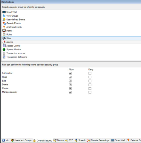

Your method works but we would like to check for a different permission. I still don’t know how to get the GUIDs on my own. Maybe you could help. We would like to check for Alarm, Full Control, Allow as seen in the screenshot below. Thanks.
“Full control” is not one permission. “Full control” is a shortcut implemented in the management client which in one go sets the four permissions I mentioned above.
Okay thanks. Unfortunatly the GUID you gave me above won’t fullfil our requirement so I’m trying to chose another one but I don’t know how to get them on my own. Would you be able to help me get the GUID for “Management Server” "Manage security"
Or if you could help me find the GUIDs on my own I wouldn’t need to keep bothering you. Thanks again for all of your help.
Use the Config API Client sample, navigate to the right objects, use a breakpoint in the sample code and get the GUID etc. in that way.

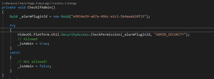

I have from the Config API Client dialog the GUID
- [0] {VideoOS.ConfigurationAPI.ValueTypeInfo} VideoOS.ConfigurationAPI.ValueTypeInfo
  Name   "Management Server"   string
  TranslationId   "PropertySecurityNamespaceManagementServer"   string
  Value   "e9914e39-a67a-496c-a3c1-5b4aaab28f15"   string
Please try this one instead.
No that did not work either. With the attached code and attached permissions it still fails.
It seems to me there should be an easier way to check for permissions via the API.

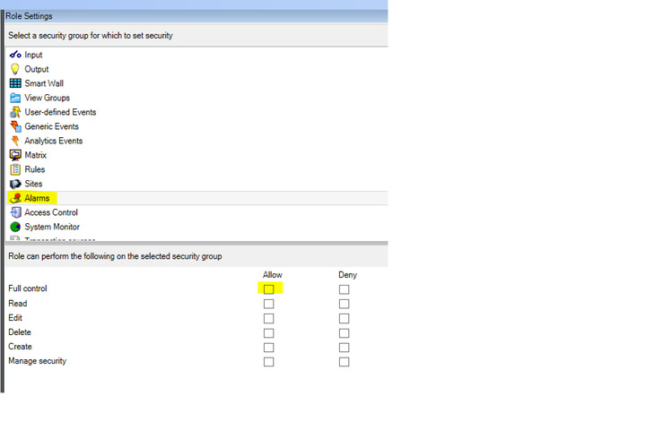

The screen capture from the Management Client is pointing to something different than the earlier one. I wonder if we have a mix-up?
Also I do not understand how checking for access to write alarms was not right, can you tell me what you try to accomplish?
Sorry the most recent screenshot was a mistake. I tried Management Server, Manage Security but it’s always returning false.
