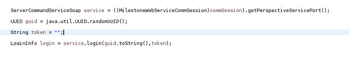

Hi Everyone, i am implementing the Login and i am using the following wsdl file http://ip:port/ServerAPI/ServerCommandService.asmx?wsdl, is it the right way??. I had some problems with the http://ip:port/ManagementServer/ServerCommandService.svc?wsdl file

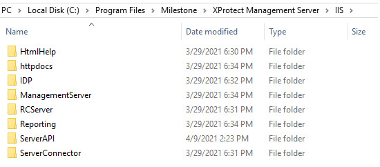

In addition, i am invoking the Login method and i am getting the “HTTP/1.1 404 not found” error message. my code in Java is (see image 1) and the packets on wireshar are the following (see image 2). Also, the Milestone VMS has installed the follwoing endpoing (see image 3).
image 2I don’t know why didn’t find the method.
Please let me know if you need more information.

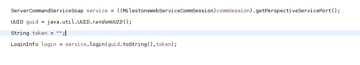

Hi, when i invoke to the login method (you can see the code snippet above), I am getting the following error: “The server sent HTTP status code 415: Cannot process the message because the content type ‘text/xml;charset=“utf-8”’ was not the expected type ‘application/soap+xml; charset=utf-8’”. Also, could you please tell me how can i test the web service SOAP (some software client like SOAPUI or Postman) ??? thanks.
