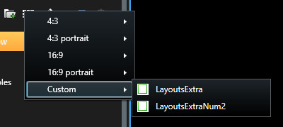

You would create multiple classes inheriting the ViewLayout class.
To explain further I am taking a concrete example. I create a new plugin (I call it LayoutsExtra) using the plugin template. This plugin already have a ViewLayout class, I create a copy of the class and now I have LayoutsExtraViewLayout.cs and LayoutsExtraViewLayout2.cs, in the second class I change the DisplayName (can later change rectangles etc.)
So now I have two ViewLayout classes and then I need to change the PluginDefinition.
The two layouts should have different Ids, so I have the code:
internal static Guid LayoutsExtraViewLayoutId = new Guid("f9a689af-1b0c-49ba-9c5f-fd782fa450c3");
internal static Guid LayoutsExtraViewLayoutId2 = new Guid("39396F7A-29C7-48E9-8103-0E4CB3D65F72");
(The first line was made by the template the next by me.)
Now I go back to LayoutsExtraViewLayout2 and make sure it uses the new id:
public override Guid Id
   get { return LayoutsExtraDefinition.LayoutsExtraViewLayoutId2; }
   set { }
Now the final task is to signal that there are two layouts so I change:
private List<ViewLayout> _viewLayouts = new List<ViewLayout> { new LayoutsExtraViewLayout(), new LayoutsExtraViewLayout2() };
Build and test, I am done.
