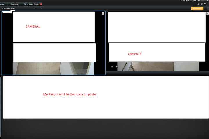

In my plug-in I don’t have a panel or picturebox to view the image.
My view has two cameras and a plug-in.
And I want to create the copy and paste button on my plug-in

I’m creating a ViewItemUserControls and I think the problem is that the ViewItemUserControls are generated and disposed as the user selects different views…
How can I solve it?
