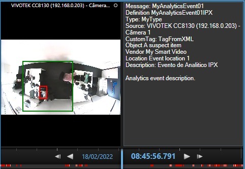

Hi, I'm having an issue with timestamp on my integration... I am from Brazil and my server is my local PC (localhost), but everytime I send an analytics event trigger to Xprotect through XML and Analytic port, the timestamp goes back 4 hours, any idea?
This is the event

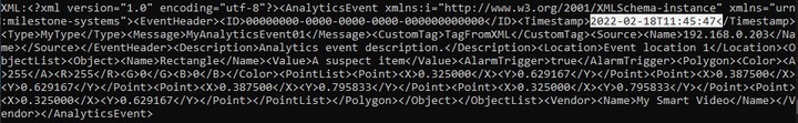

and here is one example of the XML string with the timestamp highlighted

If you explore the TriggerAnalyticsEventXML sample you notice:
analyticsXml = analyticsXml.Replace("$timestamp$", DateTime.Now.ToString("yyyy-MM-ddTHH:mm:sszzz"));
Notice the three z, this will include the timezone information.
Milestone has a known issue where the culture of the PC could cause the date time format to be misinterpreted by the server.
Please replace the line with:
analyticsXml = analyticsXml.Replace("$timestamp$", DateTime.Now.ToString("yyyy-MM-ddTHH:mm:sszzz", CultureInfo.InvariantCulture));
Alternative solution is to convert the time to UTC time and then submit it to the server without the timezone information:
analyticsXml = analyticsXml.Replace("$timestamp$", DateTime.Now.ToUniversalTime().ToString("yyyy-MM-ddTHH:mm:ss", CultureInfo.InvariantCulture));
Most important, before changing code please check that the involved PCs and servers are in the correct time zone, and if they are correctly set with “Adjust for daylight saving time automatically”.
