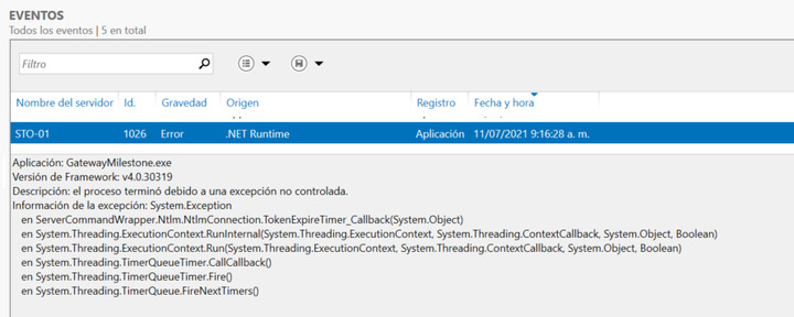

Hi, when the token is refreshing, i am getting the following error (you can see it on the image attached) "Exception TokenExpireTimer_Callback". we have setted /implemented the OnTokenRefreshed method. I think that there exception is generating on the dll
Please, we need to fix it. can someone help us from Software Team ???
the exception is generating in the ServerCommandWrapper file and my app is closing. I cannot catch the exception on my app.

Hi Kito, i have my own app, i am not using the TCPViewer app. the exception is in the ServerCommandWrapper dll file. another question, how can i set a shortened token timeout??? actually it is 4 hours.
