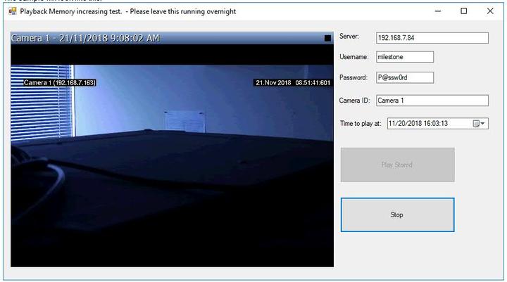

The sample will look like this,

I have attached the MilesteonTest.zip - Sample Application which is a Dot Net WinForm application and written using Visual Studio 2017. Its zipped size is 51MB as it includes MIPS 2016.
