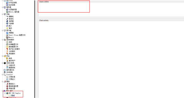

Hikvision plugin, integrate your MIP SDK, users online always empty , do you know why ?

please check the screenshot, the chat is like demo Milestone provide

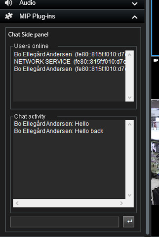

For me the sample works.
I tested by having the plugin run in a Smart Client and in a Management Client and then they could see each other..
In Management Client
In Smart Client
If it does not work for you the simplest explanation is if the Event Server is not running as the sample is using Message Communication via the Event Server. As a first step of troubleshooting check this.
hi, we have sereral Milestone environment, just two of them has this problem, we checked all server including Event Server works, even reinstall, any other aspect we can check ?
Maybe this - https://developer.milestonesys.com/s/article/XProtect-2020-R2-cumulative-patch-installers
Event Server
- 15/09/2020 - Fixed a problem with MIP communication service shutting down
Note this is only fitting if you are testing with XProtect 2020 R2.
What version are the two servers that fail?
