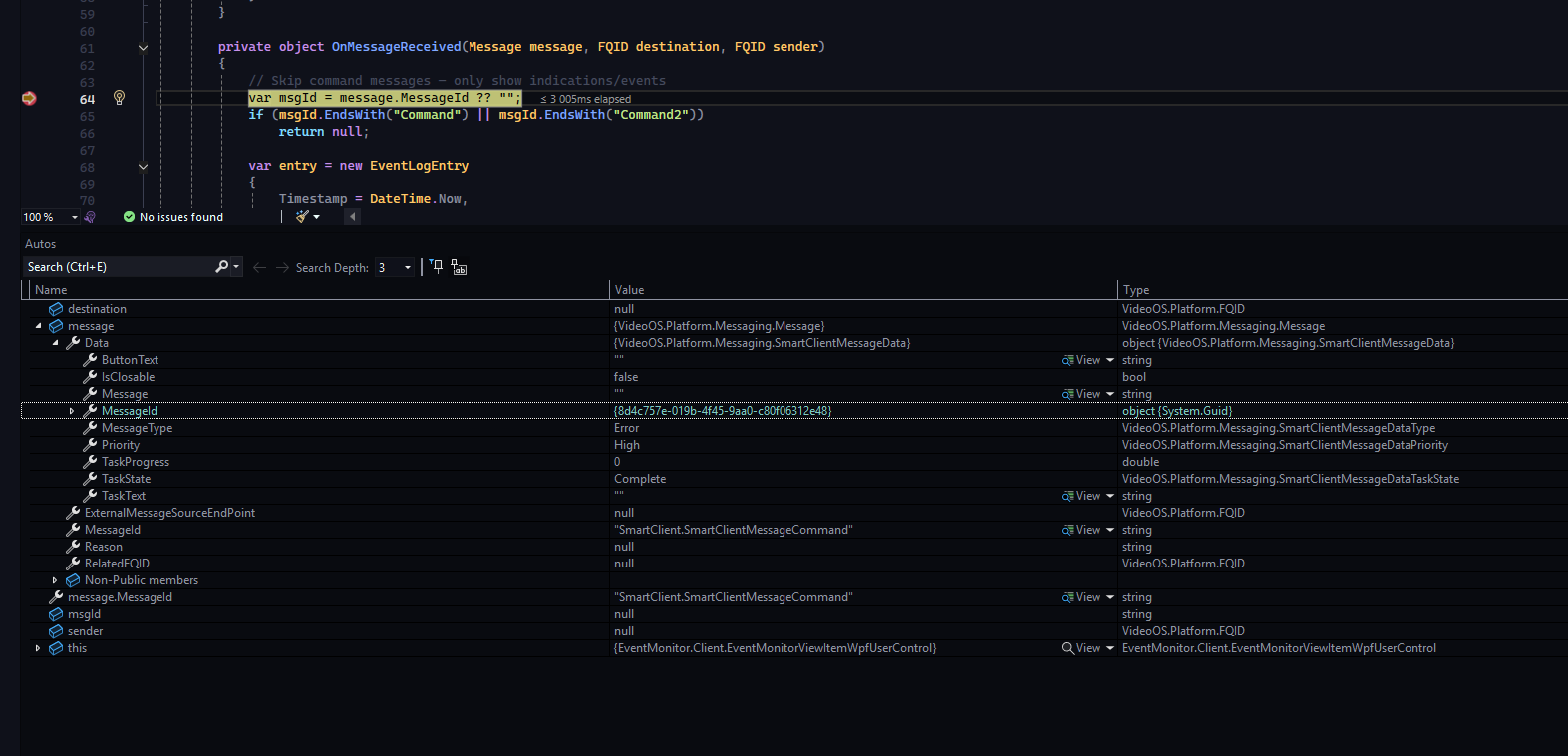

@Bo_Ellegard_Andersen I play little but, I get no event when enter interdependent play mode, I get an event for select or deselect a camera. “SmartClient.SelectedCameraChangedIndication” and “SmartClient.SelectedViewItemChangedIndication” do I something miss ? what are the SmartClient.SmartClientMessageCommand is this task releated sutff because the cary no stuff
You are right. I made a flaw in my testing, when first pushing the independent playback I was both giving the camera focus and entering independent playback. There is no message when you enter independent playback. This is bad news, I must conclude that there is no message you can use to detect independent playback.

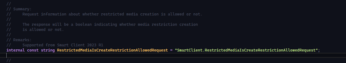

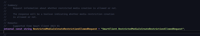

Second One: I saw this, but sounds like this is just and info is user is allowed or, and not if he created one.
or just sub to SmartClient.RestrictedMediaCreateRestrictionCommand, but its internal ?
