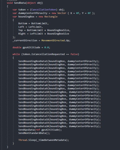

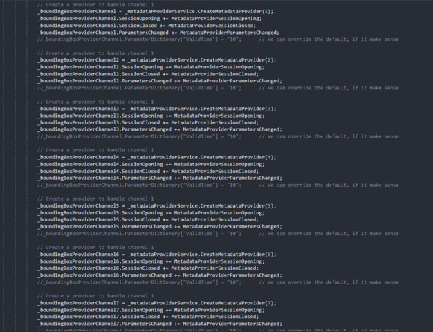

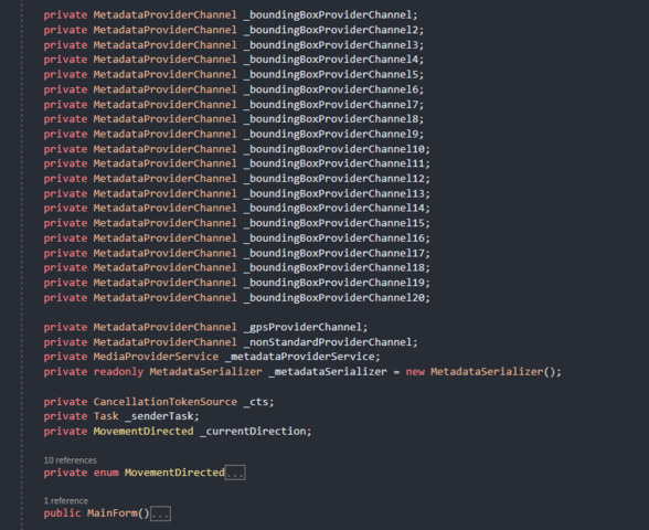

I tried the sample you mentioned, and adding the 3 drivers sample did not show the error, but when I try to add more than 19 it show the error
I have not changed the sample functions, just copied and pasted many times
like this:
as you can see, I have not changed anything on the sample, just copied and pasted a multiple times the same function
imageand as you can see too, I am receiving the Time Limit error
