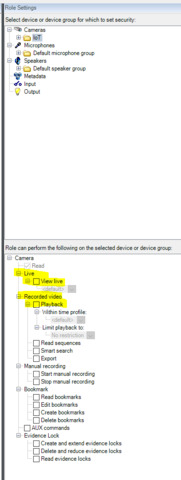

I am in the process of customizing the user roles via MilestonePSTools.
I need to be able to give and take away the right to live and playback from a camera group within an role.
The background is that a guard center may only have access to live and playback when an alarm center triggers.
If I know how the PS Script must look like, then I can send these depending on the signal input of a camera per batch by a rule.
I can read the role, add users etc. via Powershell, however I don’t know how exactly I can assign and revoke the right of a role.
See marked points, I need to enable und disable this within a Role.
Could someone please help me here?
Thanks in advance
Maik
