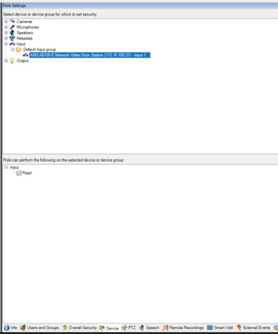

How can I control access to an input port so that a certain Smart Client user only has access during certain hours?
I can control access in a user role in Management Client, but I can’t do it based on a time profile. Is it possible to do this? If not, is it possible to write a plugin that does this?
For cameras (Live and Playback) you can use time profiles to grant access, for input you can’t use time profiles when managing access rights. Using a plugin will not enable you to extend the capabilities either.
