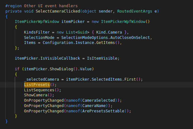

The thing that I want to do is quiet simple but your codes are not easy to understand for me. can you please tell me how you fetch camera list?
In this part I cannot debug how you fetch it.
The sample is using the ItemPickerWpfWindow to let the user pick one camera.
For getting a list of cameras through code I believe the best explanation is here.. https://developer.milestonesys.com/s/question/0D53X00006Sow5dSAB/how-to-get-the-available-cameras
In the sample Configuration Access ((https://doc.developer.milestonesys.com/html/index.html?base=samples/componentsamples/configaccessviasdk/readme.html&tree=tree_2.html)) you get a fuller overview of working with the configuration ((GetItems())) but the post above I think will more condensed give you what you need.
