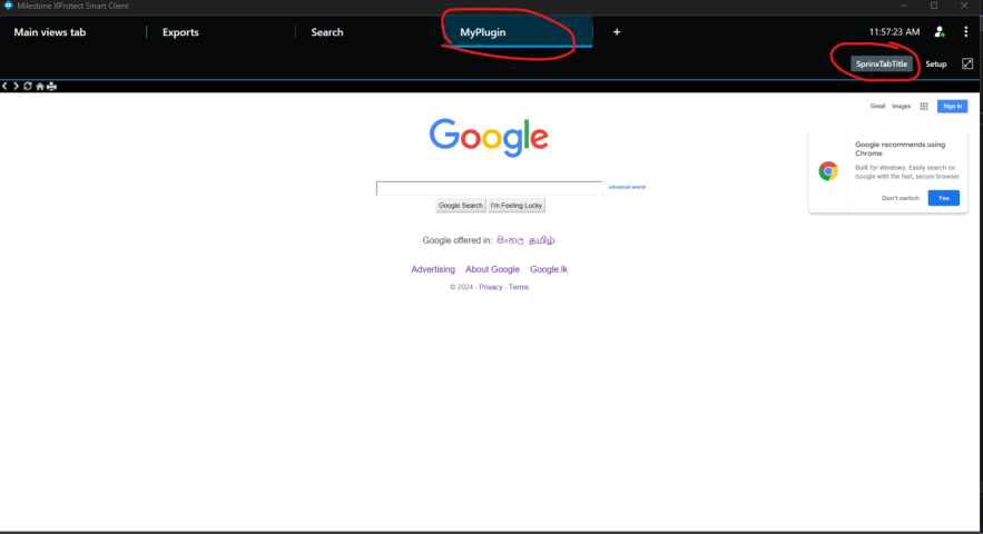

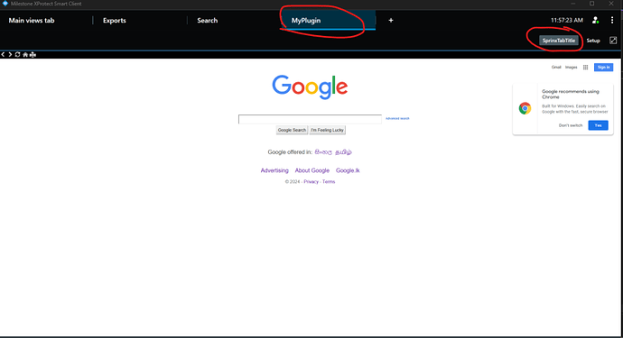

I am trying to load a website inside my MIPPlugin1WorkSpacePlugin,
So here, I’m using its built-in methods to display the website as follows
public override void Init()
LoadProperties(true);
List rectangles = new List();
rectangles.Add(new Rectangle(000, 000, 1000, 800));
ViewAndLayoutItem.Layout = rectangles.ToArray();
ViewAndLayoutItem.Name = Name;
Dictionary<String, String> properties2 = new Dictionary<string, string>();
properties2.Add(“URL”, “https://google.com”);
properties2.Add(“Addscript”, “true”);
properties2.Add(“HideNavigationBar”, “false”);
ViewAndLayoutItem.InsertBuiltinViewItem(0, ViewAndLayoutItem.HTMLBuiltinId, properties2);
What I want to do is define a new “MyWebView.xaml” and “MyWebView.xaml,cs” which contains a webview2, and put it into my workstation plugin so that I can view contents in MyWebView.xaml
so far I tried I couldn’t override the properties to load this new xaml. Can you help me with an approach for this? whether its possible or not with MIP SDK
