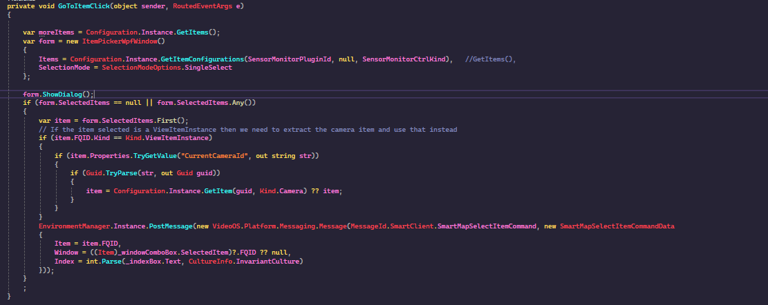

Here you see the small change:
internal static Guid SensorMonitorPluginId = new Guid("2a13d169-8803-4ab2-b45b-5c1f1c453c93");
internal static Guid SensorMonitorCtrlKind = new Guid("57d0ed4b-3baf-4fc0-aa1b-d333a82f2f12");
private void GoToItemClick(object sender, RoutedEventArgs e)
	var form = new ItemPickerWpfWindow()
		Items = Configuration.Instance.GetItemConfigurations(SensorMonitorPluginId, null, SensorMonitorCtrlKind),   //GetItems(),
		SelectionMode = SelectionModeOptions.SingleSelect
// rest of method unchanged
The code makes the Item Picker use Controller item defined by the Sensor Monitor sample.

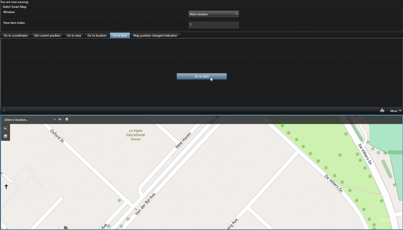

Sample: https://doc.developer.milestonesys.com/mipsdk/index.html?base=samples/pluginsamples/smartmapcontroller/readme.html&tree=tree_1.html

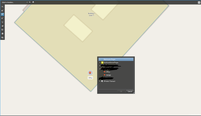

I do not know if you tried to put your item on the Smart Map manually, but if you do, you cannot place the item on a floor. If you can there is something wrong in my testing, so please let me know if you can do this.
I can manually drag an item onto the floor of a building.
But perhaps I’m doing something wrong because SmartMapSelectItemCommand does not navigate to a Controller Item similar to what you’ve tested. All I changed was changing the Items inside the ItemPickerWpfWindow, which should work as you’ve explained.
I can also place an item in a building, but it is visible no matter which floor I choose. Please try to change floor and tell me if you observe the same behavior as for cameras.

I’ve modified the GetItemConfigurations that you showed to retrieve the SensorMonitor Items. But it still does not work.

Thank you for posting the video. After seeing your video I was able to remove a controller off the map, re-add it, and as you show drag it into a building floor. Now for manual navigation the controller displays correctly as belonging to the building, and shows or hides as it is supposed to as I pick floors.
What I now observe is that SmartMapSelectItemCommand still works in the way that it does navigate to the right area of the map, but if does not display the controller until I have picked the right building floor.

@Bo Ellegård Andersen (Milestone Systems)​ Can you confirm if you tested the SmartMapSelectItemCommand to see if it actually navigated to the Controller? I tested the same SensorMonitor plugin, and when I used the code you provided, it did not navigate to the Controller item. However, when I selected a Camera, it successfully navigated to the camera.
I confirm this.
I suggest you modify the GetItemConfigurations that I show to retrieve your kind of items in your testing.
In my testing I find that SmartMapSelectItemCommand works for MIP items. When using it to navigate to items in a building floor I have observed a difference in behavior: For cameras the map finds the correct area and makes sure the correct floor is picked. For MIP items the map finds the correct area but doesn’t pick a floor.
