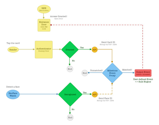

Hi Bo,
Please see the attached diagram. I am trying to achieve 2FA to unlock the door using NEC’s Neo Face. Their software can send the GUID as a stream to milestone proxy. However, the access point (reader) side cannot do so.

Hi
Thank you for the diagram – it provides a very overview of what you are trying to achieve. And I’d like to add, that it’s a very interesting application.
