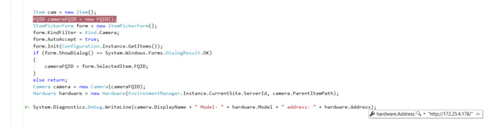

This was my test method.
private void HardwareProperties()
	Item cam = new Item();
	FQID cameraFQID = new FQID();
	ItemPickerForm form = new ItemPickerForm();
	form.KindFilter = Kind.Camera;
	form.AutoAccept = true;
	form.Init(Configuration.Instance.GetItems());
	if (form.ShowDialog() == DialogResult.OK)
		cameraFQID = form.SelectedItem.FQID;
	else return;
	Camera camera = new Camera(cameraFQID);
	Hardware hardware = new Hardware(EnvironmentManager.Instance.CurrentSite.ServerId, camera.ParentItemPath);
	label1.Text = camera.DisplayName + " Model: " + hardware.Model + " address: " + hardware.Address;
	label1.Text += Environment.NewLine;

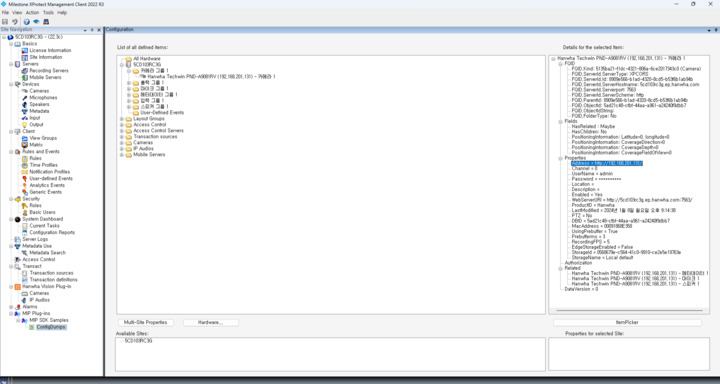

I have checked it using the ConfigDump project. Here is the image providing address without the port.
However, Hardware properties tab shows the address with the port number.

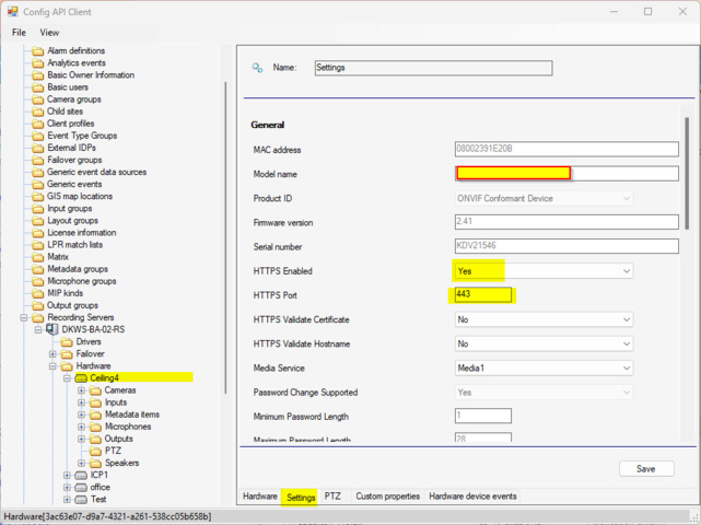

Could you test with the Config API Client sample? https://doc.developer.milestonesys.com/html/index.html?base=samples/componentsamples/configapiclient/readme.html&tree=tree_2.html
The Config API Client sample provides the port number within the “Address”. However, in the case where a camera’s connection scheme is https, it doesn’t provide a proper value in the “Address” as it does with the http scheme.
when.httpsOn the other hand, the Management Client shows the port value with the Address.
Having looked up the Config API Client sample, I found the httpS port value in the Setting tab. Do I have to handle the “Address” value differently based on its scheme?
I was finally able to figure this one out. (At first I tested with a driver framework based driver and that one is different compared to all the regular drivers from the device pack.)
What you get is the base address of the hardware. If the property HttpSEnabled exists in the general settings of this hardware and has the value Yes, the address should be modified to use HTTPS and the port defined in the property named HttpSPort under general settings. (The Management Client does this behind the scenes.)
