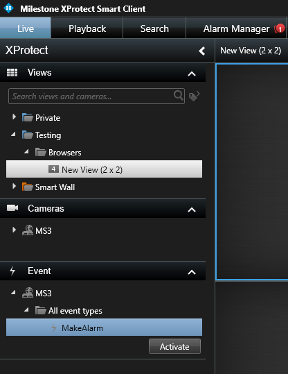

The easiest way is to activate it in Smart Client. Here’s a screenshot showing a user-defined event named “MakeAlarm” which can be activated within Smart Client and you can see it created an alarm (see the Alarm Manager tab)

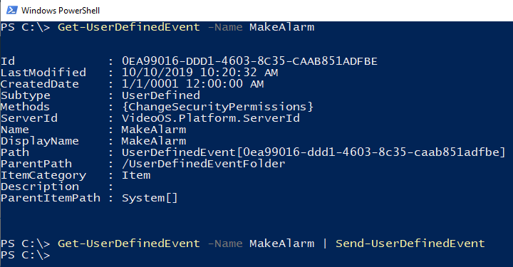

Another option if you want to test without the Smart Client UI is to use MilestonePSTools
Install-Module MilestonePSTools
Connect-ManagementServer
Get-UserDefinedEvent -Name MakeAlarm | Send-UserDefinedEvent
