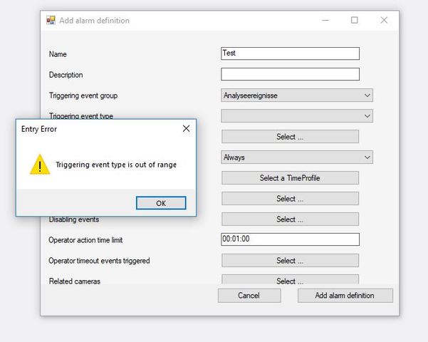

I tried the sample and made a mistake when selecting the “Triggering event group” - “Analytics Event” (Triggering event type is out of range). This is the same mistake I get in my plugin.

No, it’s not working. I get an error by selecting Triggering event group and Triggering event type. If I press Add alarm definition I get also an error (see picture).

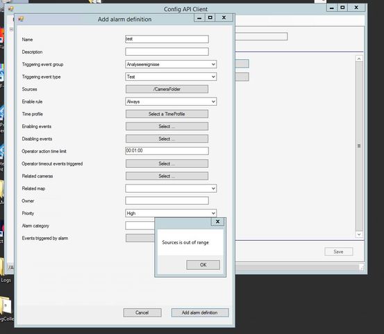

You must pick a source. You must pick a device as source, a camera or other sort of device.
I also get this error message, I use a single camera, but later I need the option “All cameras”, as I can use them in the management client.
