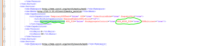

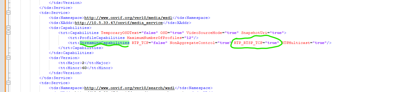

RTP/RTSP/TCP transport if indicated by the RTP_RTSP_TCP capability - see https://www.onvif.org/specs/srv/media/ONVIF-Media2-Service-Spec.pdf section: 5.13
In GetServicesResponse, media service should have Capabilities like the following:
This is my GetServicesResponse, it looks just like the one you send me, did i do it wrong somewhere?

We received Wireshark traces and driver logs trough support. You have general problems with ONVIF implementation. You response are not created according ONVIF specifications. The structure is wrong, there are missing or wrong namespaces and many other problems. For instance the GetServicesResponse from previous comment. You have nested capability tags:
<StreamingCapabilities … />
It should be:
<StreamingCapabilities ... />
This is the reason for the error message you see “Error: Protocol=‘Protocol_RTP_UDP’ does not exist, using ‘Protocol_RTP_RTSP_HTTP_TCP’ instead”. We are not able to read the list of streaming capablities you support an d we default to RTSP on HTTP. We also never reach to the point to ask for the URL for streaming and actually try to stream because you don’t support GetVideoEncoderConfigurationOptions. You respond with internal server error.
imageYou probably have other thing to fix before we reach that point.

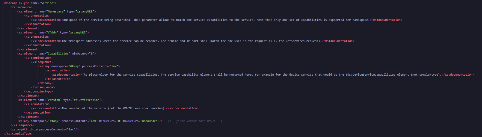

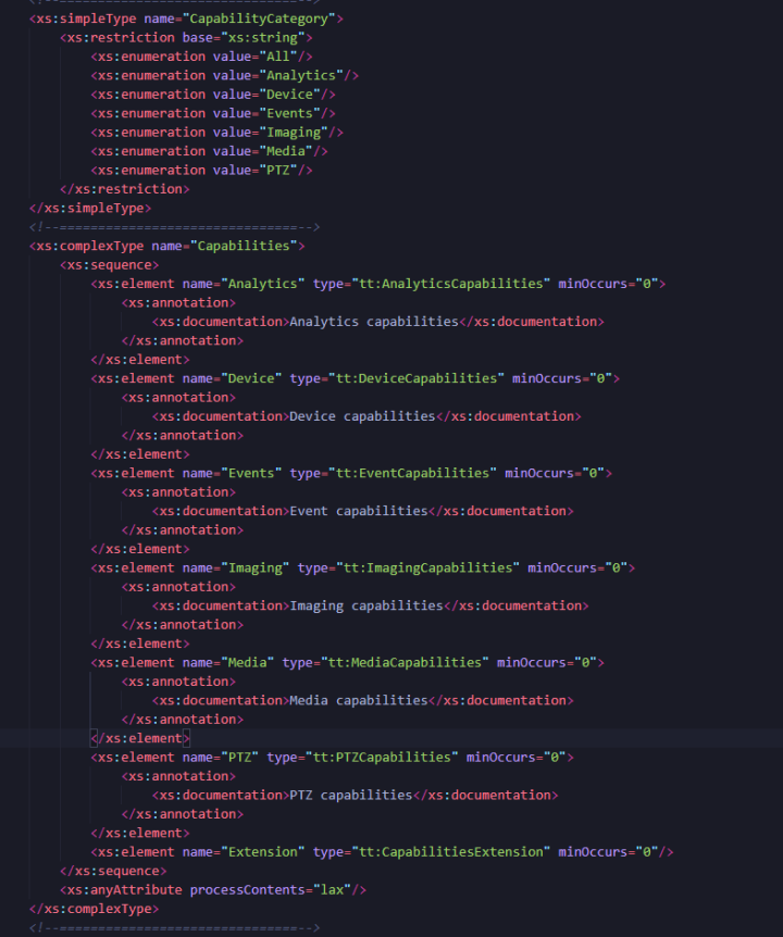

You’re right, the Capabilities element should not be nested twice - I originally implemented it that way based on a screenshot shared earlier in this thread. However, as shown in the documentation image I attached, within the Capabilities element, the child elements are simply named Device, Media, etc., with their types and not names set as DeviceCapabilities, MediaCapabilities, and so forth. This discrepancy has left me somewhat confused.

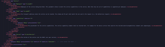

What’s even more puzzling are the official instructions for the Service object, which state:
“The placeholder for the service capabilities. The service capability element shall be returned here. For example for the device service that would be the tds:DeviceServiceCapabilities element (not complextype).”
This wording suggests that the capability element should be named DeviceServiceCapabilities, or by analogy, MediaServiceCapabilities for the media service. However, I haven’t been able to find documentation that confirms this naming convention for MediaServiceCapabilities.
