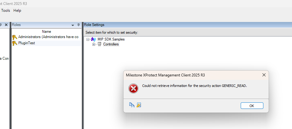

Hello Bo,
thanks for the reply.
With the Sensor Monitor sample I get the same error message.
TITLE: Milestone XProtect Management Client 2025 R3
Could not retrieve information for the security action GENERIC_READ.
ADDITIONAL INFORMATION:
VMO60013: Could not retrieve information for the security action GENERIC_READ. (mscorlib)
BUTTONS:
OK
