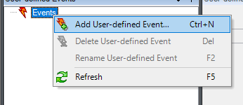

Thank you very much. Do you have any example on how to create your own custom events (and their actions) and prevent the user from adding events to the tree?
Example: Disable the functionality to add/remove/rename
Unfortunately there is no sample, you should be able to place your plugin in the Events section of the Management Client tree.
On disabling the functionality I am guessing
virtual bool VideoOS.Platform.Admin.ItemManager.IsContextMenuValid
should be able to help, this is a guess as I have answered without testing it, please let me know if you get it to work.

Hi @Bo Ellegård Andersen (Milestone Systems)​ ,
I tested VideoOS.Platform.Admin.ItemManager.IsContextMenuValid and works perfectly, thank you.
