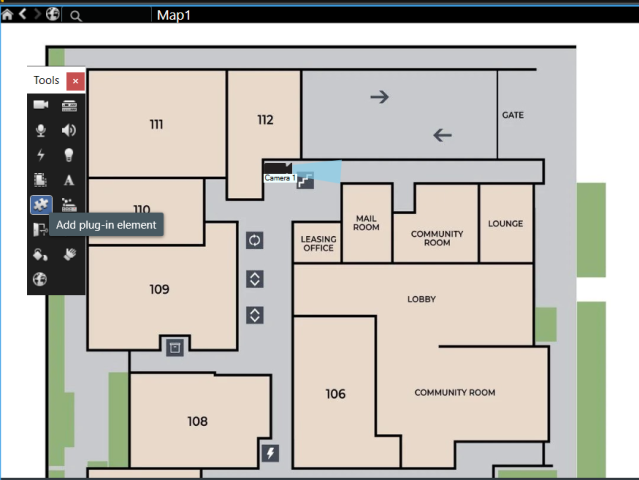

How to Add a Custom Image Icon on a Simple Map View
In MIP SDK Plugin, I want to add a custom image on a simple map view. Like we can add cameras on a map, or add a door (access) on the map, I want a custom image (like a camera or door, anything) on a camera. Please tell what classes I can use. How to do it. I am very new to MIP SDK. Thank you

Thank you very much.. After restarting the event server it is working… but now the sample code contains a lot of things I don’t need. I just want a simple icon that can be shown in the map, with no sensor, background plugin, I just want the icon that can be added in the map. I have tried to use same analogy of the code and read a Item, ItemManager, ItemNode, PluginDefinition classes in the Docs. I have written this code. My .ico file contains all six resolutions as mentioned in the Docs. The sample code that you provided is working after event server restart, but my code is not working (plugin icon is being shown in the management client but not in the smart client). Please if you can see this code and guide me where I am going wrong. Thank you very much for the help. Very grateful.
