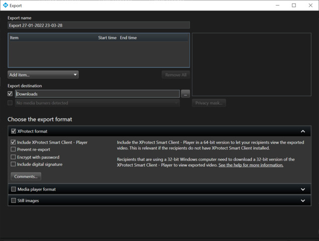

Hi,
I would like to export video with XProtect format and also need to add some additional json data and Smart Map.
Can you please suggest if it is possible or not? If it is possible how we can implement this?

But those will not help in our use case, the use cases are
  • We have developed the custom plugins where see the NVR playbacks of All camera
  • Also we are displaying camera location on Map
  • Now we would like to provide export features where we can export playback of some time interval and also camera location during that time duration
  • We would like to export the data into XProtect Player format that include video of all camera (Specific time duration), Map information + Camera location (Currently we have camera location information in Json format) so when customer click on Exported file, it will play into XProtect Smart Player without installing additional dependency.
