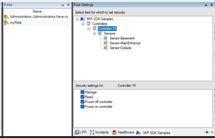

That does not really look like what I want. An exact example would be the Sensor Plugin but Instead of having sensors as a node under the plugin (Disable or hide) tree and still have it show up in the Roles.
Below is an visual example.
But don’t have it shown under controllers here

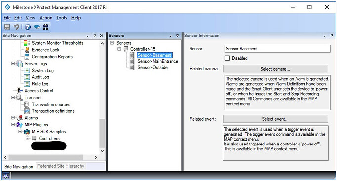

The ItemNode governs the icon seen in the Site Navigation tree and Role Settings. I did a quick experiment and for the sample I modified SensorMonitorDefinition.cs, line 99, and added
PlacementHint = PlacementHint.Hidden
Sensor are now gone from the Site Navigation tree but still present in the Role Settings. I guess this quick experiment of mine fits what you want to achieve.
