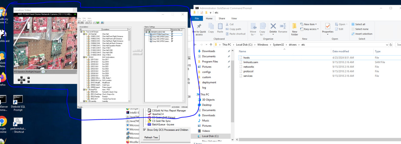

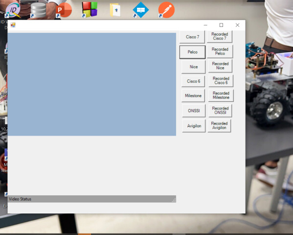

As from the pic, inside the blue box, you can see it shrinked
but before it looks like this
in second picture and third picture, it can be seen, the main app is bigger, but as the video opens, it shrinked (as seen in first picture)
