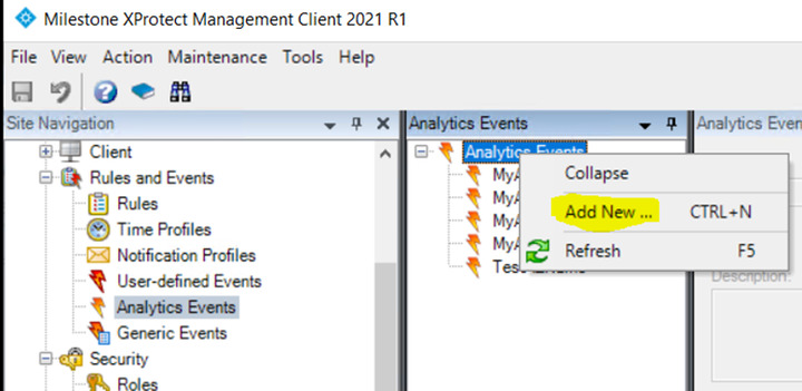

The simplest way is 1) to generate an Analytics Event, 2) to add new alarm definitions which is triggered by the Analytics event 3) to make new rules on Management Client.
  1. Create an Analytics Event on Management Client for triggering the Analytics event.

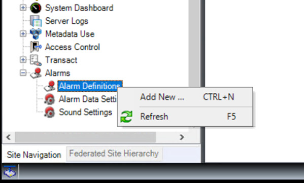

  1. Add a new alarm definition for triggering it (please make sure to configure your Analytics event with this alarm) on Management Client.

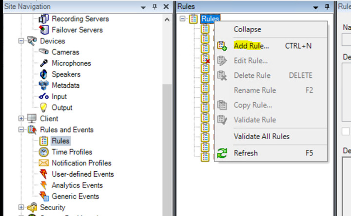

  1. To make new rules on Management Client.

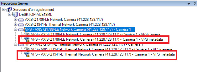

Moreover, I used the MIP SDK and implement a background plugin to automate the send of events from the Milestone xprotect event server too. But, when I try to read the metadata in this background plugin through this line of code: List _items = Configuration.Instance.GetItemsByKind(Kind.Metadata);
_items always is empty and no metadata is returned although it exists on the server.
Regarding GetitemByKind, I found a similar question. Please read this answer below link and explore ConfigAccessViaSdk sample. https://developer.milestonesys.com/s/question/0D53X00008w40RnSAI/get-cameras-listed-in-recording-server-management-client
