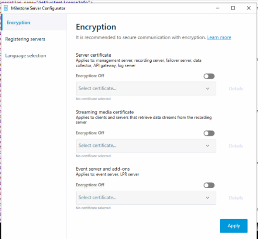

My goal is to run a simple HTTP-based development environment, understanding that this would only be for internal/local testing and not for production.
Please note I kept all the encryption turned off with TLS is disabled, again I have the same issue

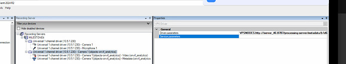

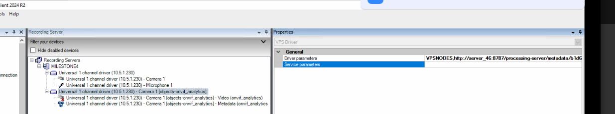

Could it be that you have VPS hardware that was created (you’ve subscribed to a metadata/video topic) when your AI Bridge was running secured ?
If that’s the case you should go to that VPS hardware and edit its URL:

But VPS driver url is already in http, But not able to connect.
That’s odd.
Could you unsubscribe and re-subscribe to the topic again (just to double-check if something got cached). It should have worked (adjusting the url on MC, I’ve done this in the past).
Mind also using latest version of the PS Admin Plugin (from milestone download page).

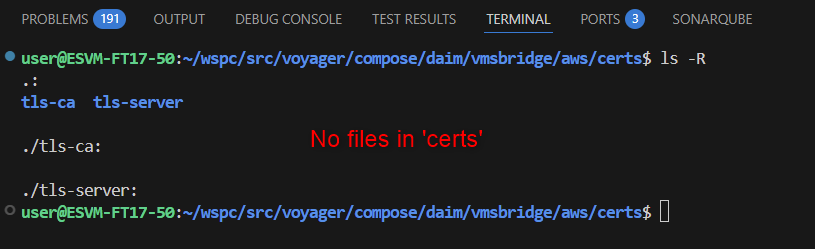

Would you mind removing all files below ‘certs’ folders.
Follow-up questions:
which AI Bridge version are you using ?
which version of the VMS it’s being used ?
Can you attach the logs of the containers ?
BR,
aibridge is 2.0.1
vms is 2024 R2
I removed certs and following are the logs
