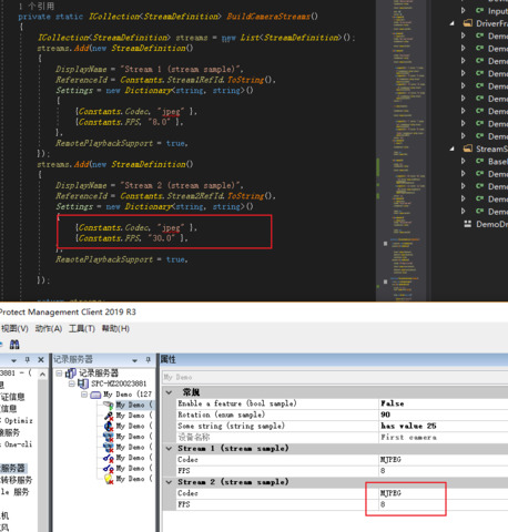

Hello, I am develop a driver by mip driver framework. But when I create our camere parameter configuration. I change the value to our camere,but the value is show in manage client that I defined this field in BuildFields function. And I test this phenomenon in demo driver. The value in StreamDefinition isn’t changed,and the value in CameraDeviceDefinition is changed.

I remove all camera,and add new camera and the phenomenon is the same. I only change the demo driver on what I screenshot. Can you test on your side?

I follow the steps what you described, and the result is the same, the field setting in streamdefinition is no changed. And when I change the field ​in cameradevicedefinition, It is changed in UI.
I was able to reproduce the behavior that setting StreamDefinition.Settings.FPS in the DemoDriver had no effect. I will do a deeper investigation in cooperation with Milestone Development.

We have been attempting to set the defaults in the wrong place. In order to change the defaults you should instead modify the BuildFields() method.

Your code for changing the defaults was correct, that it did not have the indented effect was caused by a bug in the recording server implementation of the driver framework. The bug will be fixed in 2020R3.

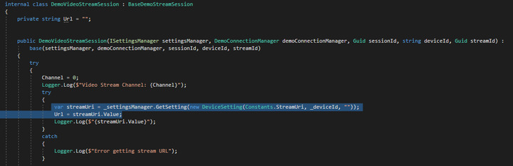

Have you had any luck retreiving the values to do something usefull with them?
I have a device setting called “StreamUri” which shows up fine in the Management Client UI.
When I try to get the Device Settings in a way similar to how the axample shows how to get metadata device settings, which works fine, the function returns null most of the time but I have seen it return the value once:
