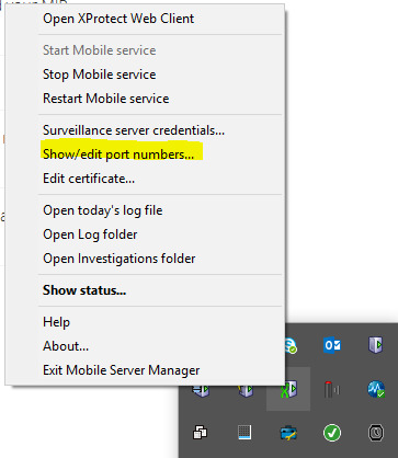

I installed essential+ in my notebook. But mobile service doesn’t work. 8081 and 8082 ports are already used by other application. How can I change?

Use the tray icon / manager.
