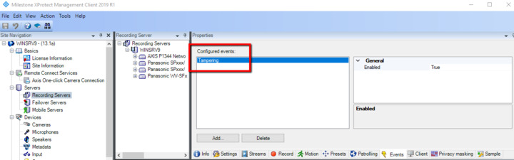

I added configured event Tampering to camera:

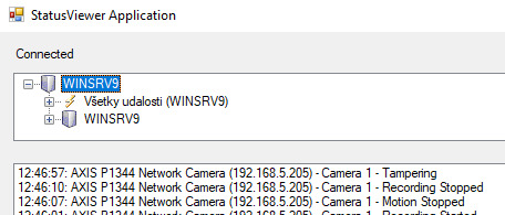

Now I am getting this event when camera is in tampering state:

The Recording Server does not have a concept of a camera being in a Tampering state. This means the best you can do is to subscribe to the Tampering event, and alert users based on the event.
